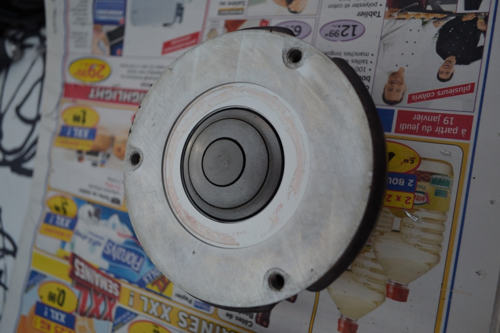

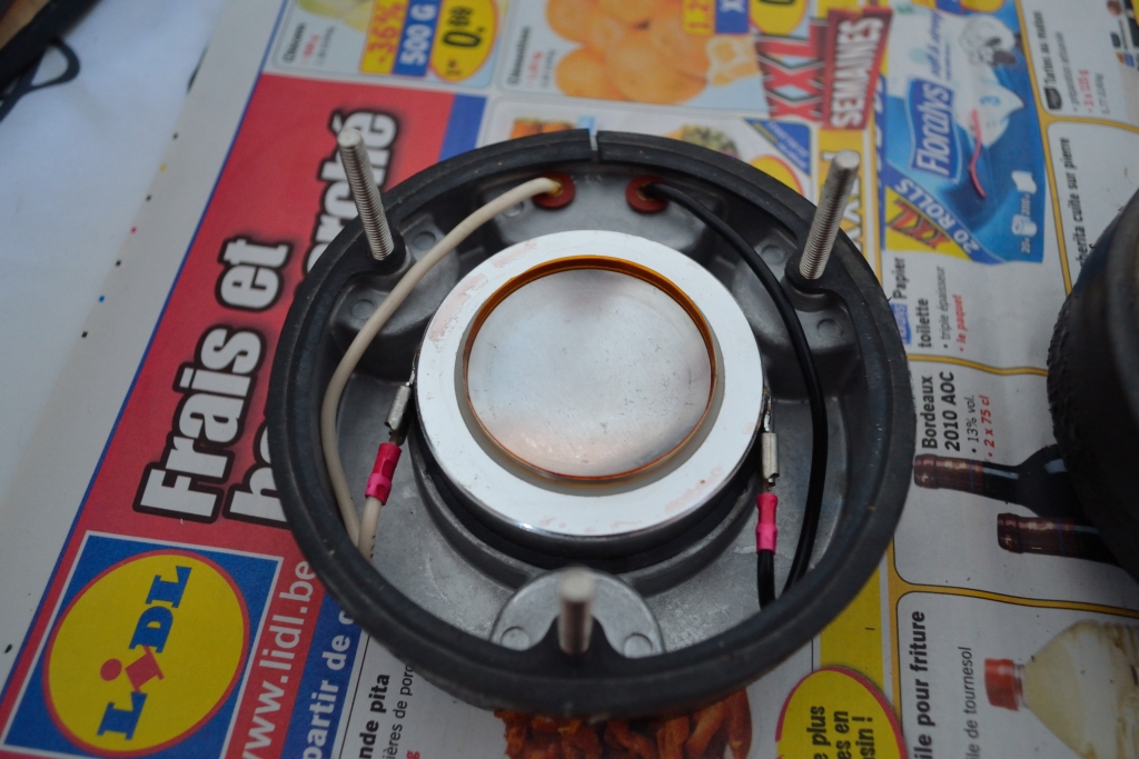

voici une photo pour montrer un peu mieux les courbes du pavillon

parce que vous aimez ca des photo de l'interieur de la compression, on y vois de belle piece de phase concentrique qui ne sont pas sans rappeler celle d'une 802
LeTOF
Messages : 1803
Localisation : Oise
Re: Emilar EC 175-8
Message par LeTOF »
Curieux montage ...Ca marche comment pour le centrage ?? La suspension est en métal aussi comme la membrane ??

Vinc
Messages : 4743
Re: Emilar EC 175-8
Message par Vinc »
non la suspension n'est pas en metal
Jonas designed a radical silicone suspension for the 44mm aluminium diaphragm, which avoided the pitfalls of typical roll, tangential and diamond pattern surrounds, and provided excellent mechanical damping. Conventional all-aluminium diaphragms have a serious problem with tearing the suspension if they recieve signals below their normal crossover frequency. Jonas's supension eliminated this common failure mode, so Emilar drivers not only sounded good, but kept sounding good for longer than other drivers. A later refinement of this suspension technique substiuted a low-mass PET ring for the original silicone component.
et pour les deux questions:
The basic dimensions and geometry of the diaphram, phase plug, and throat are the same as in the annular phase plug style altecs. My EK's don't have the original phrams, but i'm quite sure they use a phram with a mylar surround similar to the less desireable "symbiotik" Altec phrams.
Jonas Renkus was the founder and cheif engineer at Emilar, i believe he was at some point in history a part of the Altec design team. He held several patents which coincidentally are the major differences between the Altec 1 inch compression drivers, and the 1 inch compression drivers made by both Emilar and later Renkus Heinz.
Renkus designed the diaphram in his drivers to be field replaceable. The centering method he patented for Emilar consists of a very shallow counterbore in the face plate of the magnet into which fits the precision machined and centered diaphram mounting hub, no centering pins. The diaphram is then "clamped" into place providing uniform pressure oround the entire diameter of the mounting hub rather than at three single points like the competition.
LeTOF
Messages : 1803
Localisation : Oise
Re: Emilar EC 175-8
Message par LeTOF »
Sympa , faut y faire bien attention , les membranes ne doivent pas se trouver si souvent ......

michel29
Messages : 1895
Re: Emilar EC 175-8
Message par michel29 »
le diaphragme est peut etre plus facile à trouver que tu penses
j'ai croisé des moteurs Emilar semblables , pas prêté attention à la référence , dans de vieux retours de scène Martin LE400 b comme ceux ci
ce moteur semble endurant
j'avais eu à réparer un de ces retours pour une self cramée dans le filtre
certains prestataires et loueurs ont peut etre encore des rechanges
