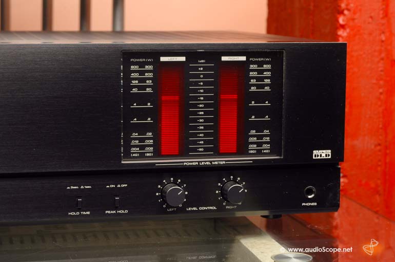

les suspensions de nos boomers JBL sont à plis : donc une mouvement moindre du boomer, des basses plus sèches et plus rapides.
Chez moi à la maison, j'utilise un couple Kenwood M2A et C-2 ; 2 x 220 watts 8 ohms ; peak 300 watts

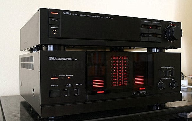

ou un couple Yamaha M-65 et C-65 : http://legendaryamps.com/latest.html
170 Watts (8 ohms) from 20 to 20,000 Hz at no more than 0.003% Total Harmonic Distortion.
195 Watts (6 ohms) from 20 to 20,000 Hz at no more than 0.007% Total Harmonic Distortion
230 Watts (4 ohms) from 20 to 20,000 Hz at no more than 0.02% Total Harmonic Distortion
Auto Class A Operating Range, 8 ohms, 20 Watts.
Dynamic Power per channel (IHF) 1 khz:
8 ohms/6 ohms/4 ohms/2 ohms 255W/315W/380W/450W
IM Distortion Ratio (8 ohms) - 0.003%
Damping Factor (1,000 Hz, 8 ohms) - 130
Frequency Responce (20~20000 Hz) - +0,-0.3 dB
Imput Sensitivity / Impredance - 1.28V / 20 K-ohms.
